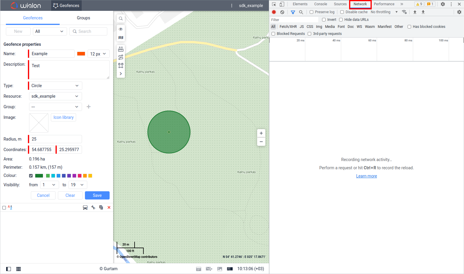

Viewing requests in the browser
When starting to explore the SDK, it is often necessary to understand which API request is being sent to the server when performing a certain action in the Wialon interface. This can be easily tracked using built-in browser tools for network request monitoring.
In Chrome browser, you can do it using the Network tab in the Developer Tools, which can be opened by pressing F12. In other browsers, this tool may open differently, as described in the browser’s documentation.
When viewing network requests, you can see the sent request, its parameters, and the response from the API server in JSON format.
Example

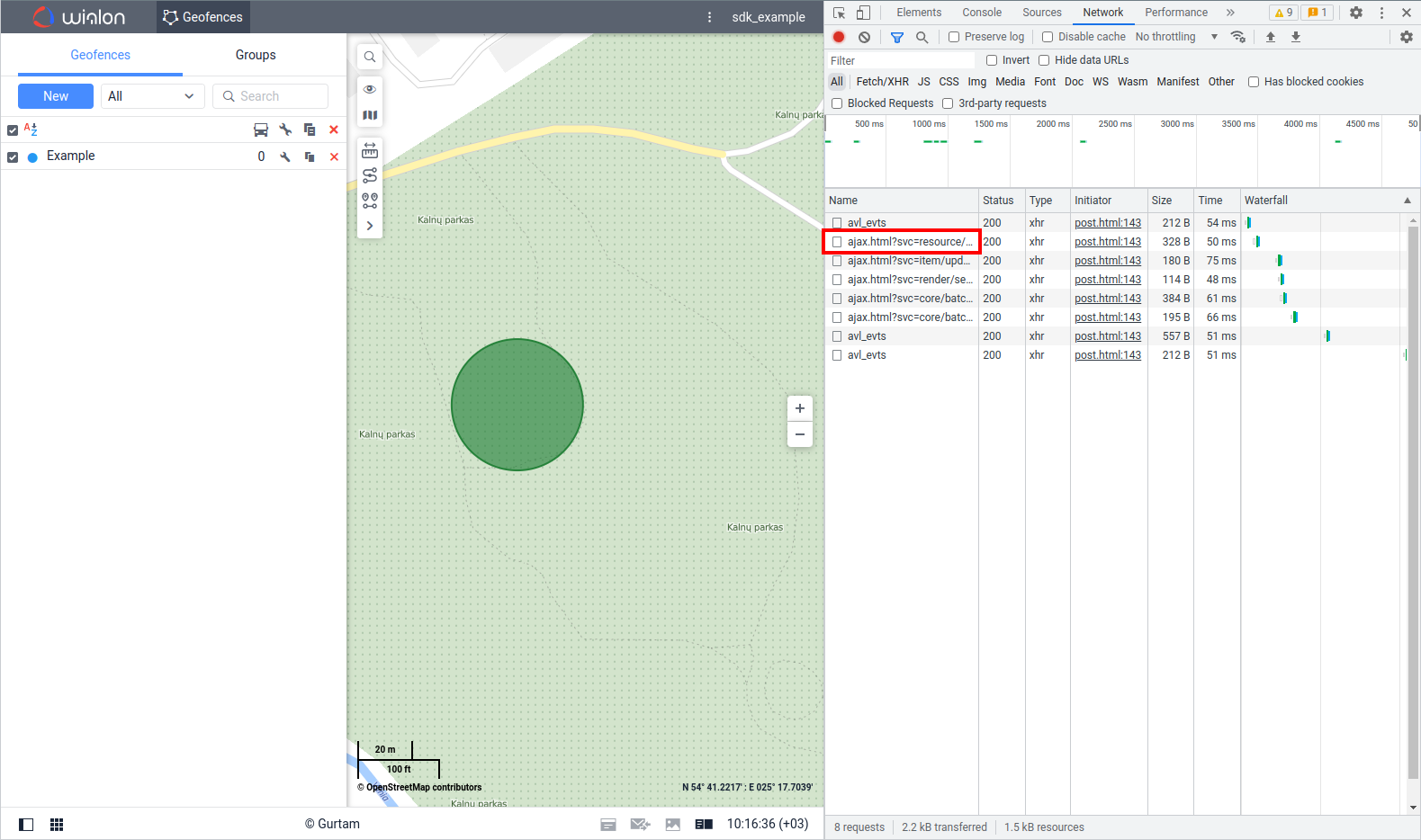

As an example, let’s create a circle geofence. Open the Network tab and fill in the Name, Description, Type, Radius, and Coordinates fields.
After clicking the Save button, the geofence will be created and the corresponding request will immediately appear in the right panel. To get information about the request, click on it.
This panel has three convenient tabs:

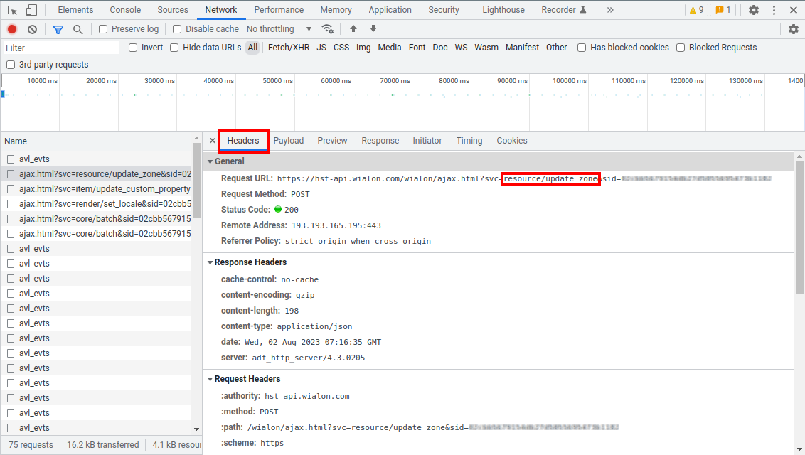

  • Headers — this tab allows you to see the full URL of the request, the method used for sending (POST or GET), the status of the request execution, and other useful information.
    Among other things, you can find the name of the API request. In this case, it is resource/update_zone.

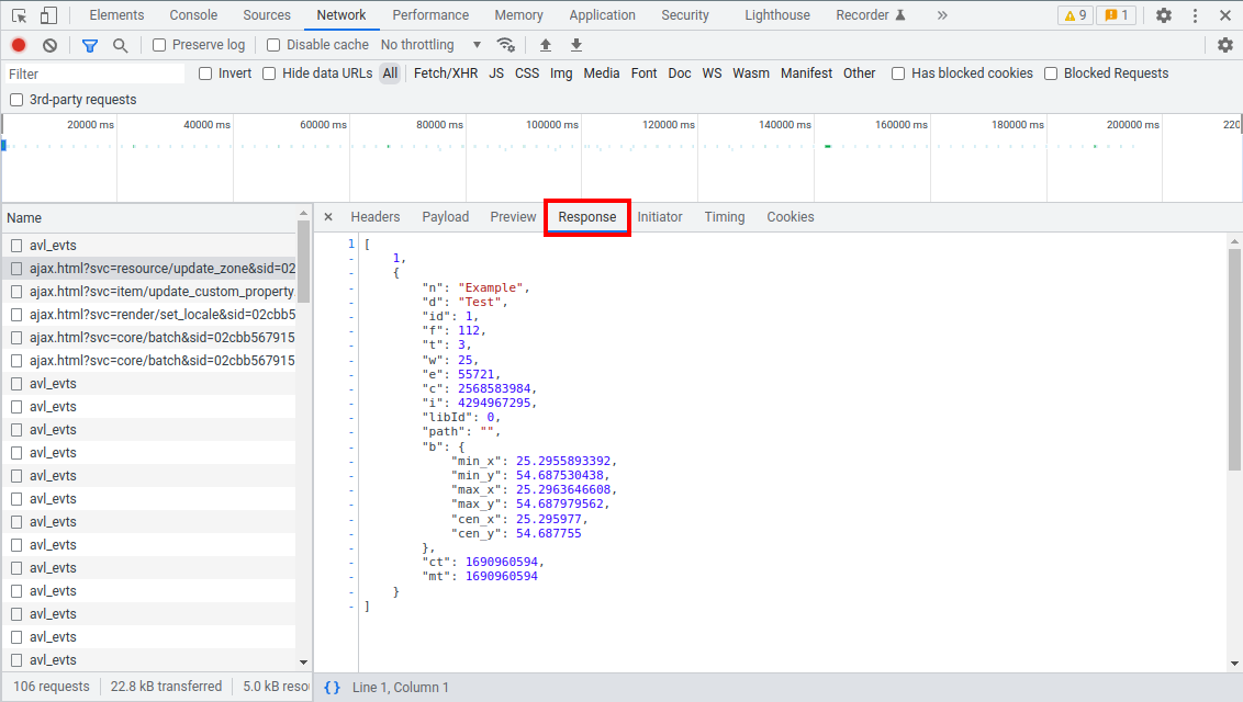

  • Response — this tab displays the response from the API server in JSON format (or its code in case of an error).
Not all functionality of the monitoring interface is based on Wialon API (an example of an exception is the Distance tool).

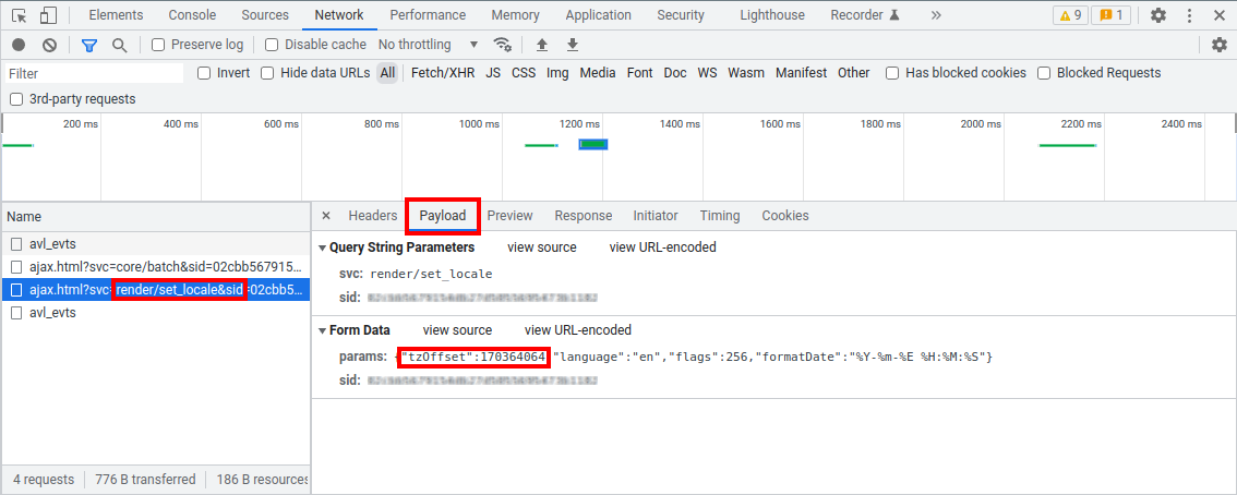

By default, when working with the Remote API, data is displayed according to the GMT+0 time zone. To change it to the desired time zone, the render/set_locale request is used. It is sufficient to execute this request within one active session.
We recommend setting the time zone immediately after authorization, thus, before performing any main actions (such as requesting messages, building tracks, etc.).
When sending the render/set_locale request, you must use the tzOffset parameter. The standard method for calculating its value is described in the documentation.
Example
As an example, let’s calculate the value of the tzOffset parameter for a client in Sydney, Australia.
The necessary values for time settings (daylight saving time and time zone) can be found in the documentation. In this case, the time zone value is 36000 (in DEC format), and daylight saving time is 0x0A270000 (in HEX format).
Next, two actions need to be performed:
  1. Apply a bitwise AND operation to the time zone using the mask f000ffff (HEX).
    Since the used operation is performed for each pair of bits, the values need to be converted to the binary numeral system:
    Time zone 00000000000000001000110010100000 (BIN) 36000 (DEC)
    Mask 11110000000000001111111111111111 (BIN) f000ffff (HEX)
    Result of the operation 00000000000000001000110010100000 (BIN) 36000 (DEC)
    In this case, the operation did not change the value of the time zone.
  2. Apply a bitwise OR operation to the result from the previous step using the daylight saving time mask.
    Previous result 00000000000000001000110010100000 (BIN) 36000 (DEC)
    Mask 00001010001001110000000000000000 (BIN) 0x0A270000 (HEX)
    Result of the operation 00001010001001111000110010100000 (BIN) 170364064 (DEC)
You can also find out the required value of the tzOffset parameter by viewing network requests while changing the user’s time zone in the web interface.

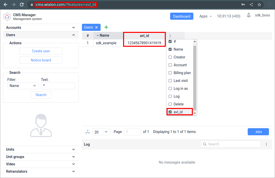

System IDs are not displayed in web interfaces by default but they can be seen in three ways:
  1. In the response to a request for searching items by property (core/search_items). We will explain it in more detail in the next section of this article.
  2. In the parameters of requests when viewing network requests in the browser.
  3. In the avl_id column in the management system.
    To make the avl_id column shown, you need to log in to the CMS and add ?features=avl_id to the end of the link. An example of such a link is shown in the image below.
