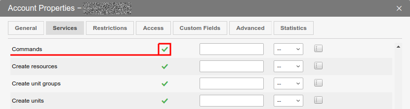

  1. The Commands service is enabled in the account.

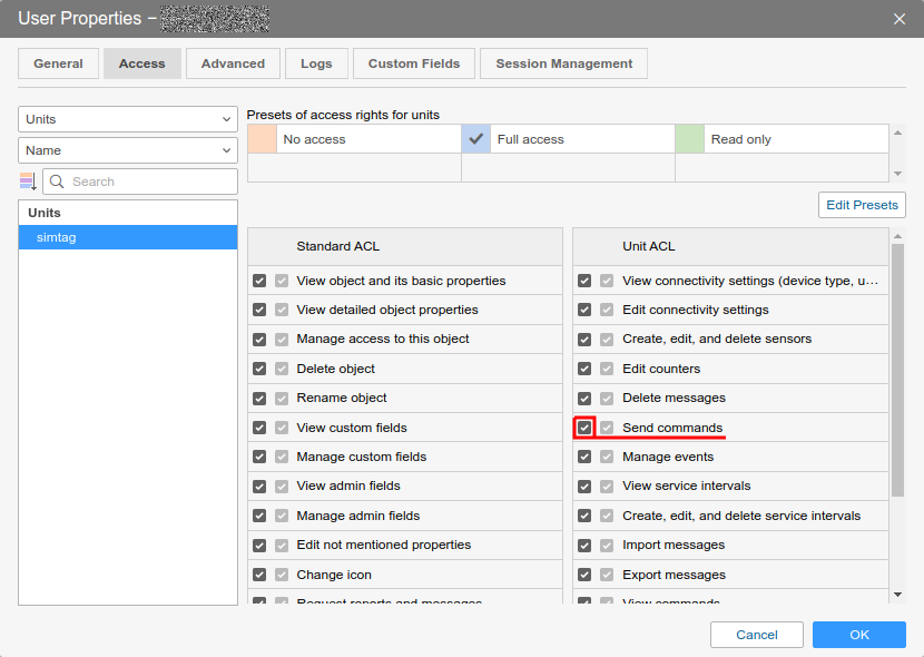

  2. The user has the Send commands special right regarding the unit.

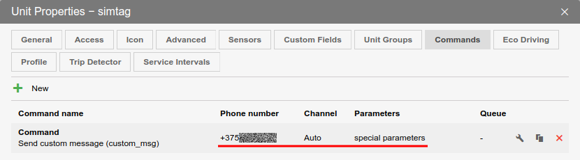

  3. The command is created in the same-name Commands tab in the unit properties.
    To create commands, the user must have the Create, edit, and delete commands special right regarding the unit.

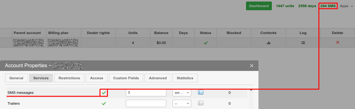

    • The SMS messages service is enabled in the account.
    • SMS must be available in the service, i.e., the counter on the top panel must be greater than zero.
      This counter is not displayed if the service uses a personal modem for sending SMS.

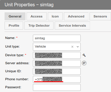

    • In the General tab in the unit properties, you must specify the Phone number in international format, to which the tracker will receive SMS.
