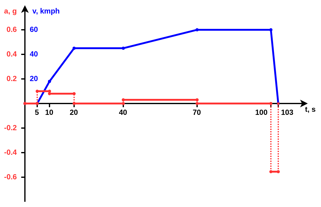

The key characteristic that helps evaluate eco driving is acceleration. This physical quantity does not seem intuitively clear, so in the framework of training it can be compared with a more familiar quantity such as speed.
Speed and acceleration
The speed characterizes the change in position over a certain time interval:
v = S / Δt,
where v is the speed, S is the distance covered in the considered time interval (or the difference in the vehicle mileage at the end and the beginning of the trip), and Δt is the duration of the interval.
We can say this formula determines the average speed within the trip. But the shorter the time interval is considered the closer the result will be to the speed that is displayed on the vehicle’s speedometer.
Acceleration characterizes the change in speed over a certain time interval:
a = Δv / Δt,
where a is the acceleration, Δv is the difference in speed at the end and at the beginning of the considered time interval, and Δt is the duration of the interval.
The average value of the acceleration per trip is almost never used in the analysis of the movement of the vehicle, so it makes sense to calculate only the acceleration over the minimum time interval.

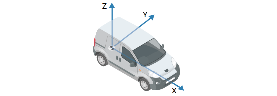

Since acceleration is a vector quantity, meaning, it has a direction, its full measurement requires three accelerometers installed perpendicular to each other. Together they form one three-axis accelerometer, where, for example, the X-axis shows acceleration or deceleration, the Y-axis shows turns, and the Z-axis shows ascents and descents.
A tracker with an accelerometer or a separate accelerometer sensor may have axes drawn on the body, it must be placed on the vehicle according to them.
There is no single rule for the direction or naming of axes. That is, the Z axis can be directed not up but down, or instead of the X axis, the Y axis can be directed forward. This information can found in the device documentation.
When installing the device on a vehicle, make sure it is firmly fixed.
