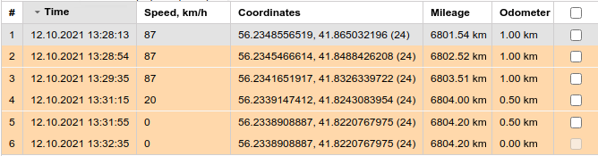

If the device sends parameters for both mentioned types of sensors at once, the odometer readings do not have to completely coincide with the difference that you get by subtracting the mileage sensor readings in two adjacent messages. This is due to the fact that the calculation algorithm for sensors may differ on the device side. In that case, it is advised to choose the sensor that shows more reliable results.
Both mileage sensors use kilometers (or miles) as measuring units. If the incoming parameter has other measuring units, you should apply a coefficient for converting incoming values to kilometers (or miles). For example, if the can_odo parameter displays the value in meters, then in the Parameter line in the sensor parameters, you will need to write the following formula to convert to kilometers: can_odo/const1000

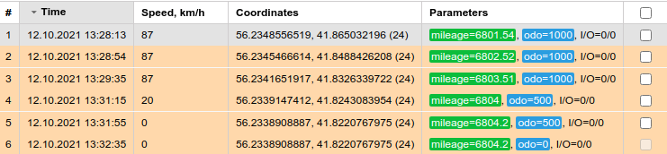

Example
Messages with the following parameters are received from the unit:
Create a Mileage sensor based on the mileage parameter, as it constantly increases while moving and does not drop to zero during a stop.
Create a Relative odometer based on the odo parameter, as it has different values while moving and drops to zero during a stop. However, its value seems too high, so try using the odo/const1000 formula.

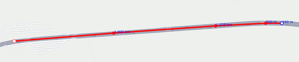

Measure the unit mileage between several pairs of messages using the Distance tool by placing the measured segments on top of the track.
Compare the obtained results:
Mileage sensor Difference with the previous value by the mileage sensor Relative odometer The Distance tool
1 6801.54 km 1.00 km
2 6802.52 km 6802.52 - 6801.54 = 0.98 km 1.00 km 1.000 km
3 6803.51 km 6803.51 - 6802.52 = 0.99 km 1.00 km 1.020 km
4 6804.00 km 6804.00 - 6803.51 = 0.49 km 0.50 km 0.500 km
5 6804.20 km 6804.20 - 6804.00 = 0.20 km 0.50 km 0.160 km
6 6804.20 km 6804.20 - 6804.20 = 0.00 km 0.00 km -
The values are approximately equal, therefore, we can assume that the parameters for both sensors are selected correctly.

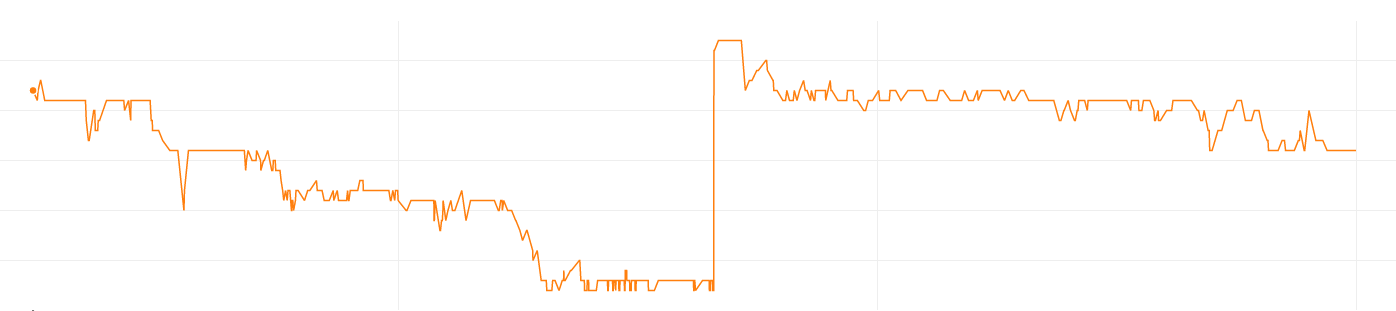

FLS
You can use the parameter in the Fuel level sensor if
  • its value does not change when the engine is off;
  • its value gradually decreases when the engine is running;
  • its value decreases faster when driving or operating under a load than when stopped or with no load;
  • its value fluctuates around the actual value during engine operation and movement;
  • its value increases sharply during fuel filling.
In contrast to fuel consumption sensors, the parameter from FLS may behave not the way described above, because fuel drain may happen during a stop or movement, the unit may move at an angle, the temperature may change significantly during the day, fuel may contain impurities, etc. Find more information about fuel control issues and their solutions in the Expert articlesFuel section.
Below is an example of the FLS parameter changing chart, which covers the trip and filling intervals.
In some cases, the FLS parameter behaves in the opposite way: when the engine is running, its value increases, and when filling, it decreases. This difference will be neutralized after the tank is calibrated and its results are entered into the Calculation table.
