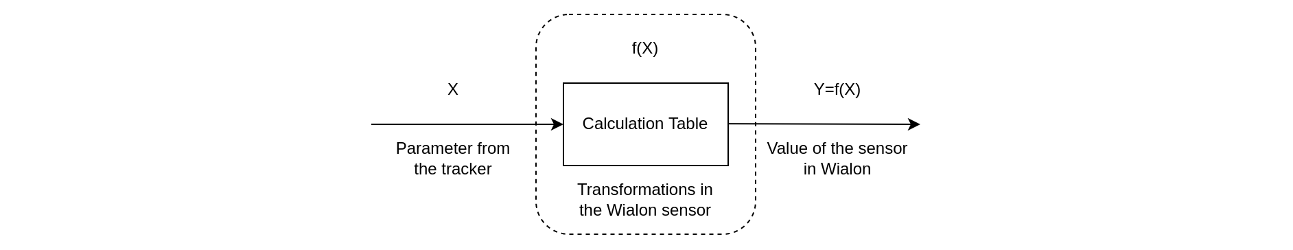

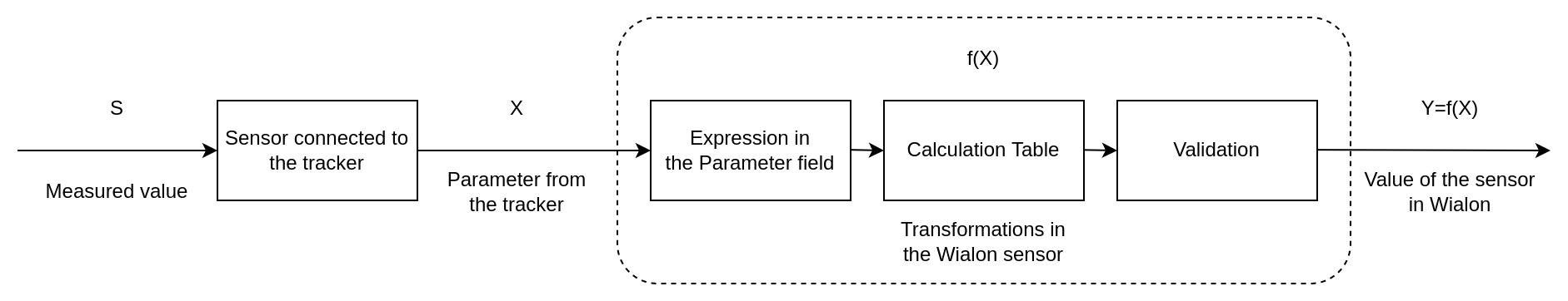

Schematically, the use of sensors can be represented as follows:
  • The sensor connected to the tracker measures some physical quantity; let’s denote it by S.
  • The sensor converts this value and transmits it to the tracker. The X parameter comes from the tracker to Wialon.
  • Based on the parameter, a sensor is created in Wialon. Then, f(X) transformations are applied to the parameter in the sensor to obtain a human-readable Y value.
  • Ideally, after transformations in the sensor, the value Y=f(X) should be equal to the value S measured in the first stage. Further, Y will be used in tooltips, reports, notifications, and other Wialon functionality.
Since this article only explains the process of setting up the calculation table in Wialon, we will pay attention only to the following elements from the scheme above:

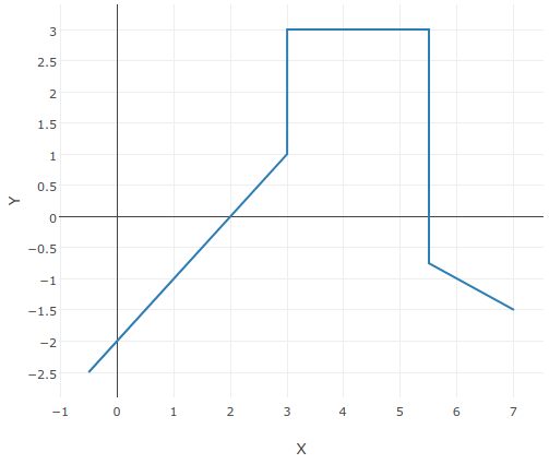

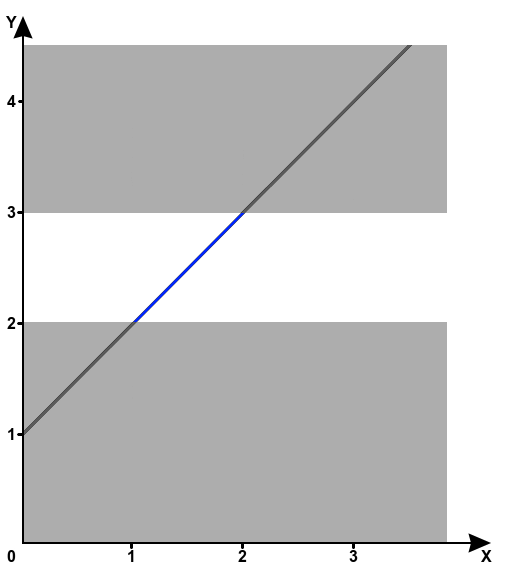

As an example, consider a table with the following values:
Otherwise, this condition can be written as follows:
  • From −∞ to 3 (not including), the equation Y=1⋅X-2 is applied.
  • From 3 (including) to 5.5 (not including), the equation Y=0⋅X+3 is applied.
  • From 5.5 (including) to +∞, the equation Y=-0.5⋅X+2 is applied.
An example of a chart obtained when filling in the calculation table

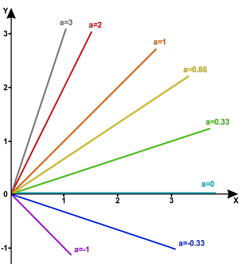

a is a slope coefficient of the line
With a=0, the slope will be 0°; thus, the line will be parallel to the X-axis.
With a=1, the slope will be 45°; thus, the larger the coefficient, the closer the line will be to the Y-axis.
With a=-1, the slope will be −45 °; thus, negative values of this coefficient tilt the line down, and positive values — up.
An example of a chart of the Y=a⋅X line with different slope coefficients
Determining the coefficient of the line slope is quite simple: its value equals the ratio of the change in Y to the change in X.
As an example, consider the green line in the chart above. It shows that Y increases from 0 to 1 when X grows from 0 to 3, which means that the coefficient for this line is a=(1-0)/(3-0)=1/3=0.33.

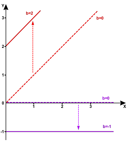

b determines the displacement of the line along the Y-axis
When b=0, there is no displacement.
When b>0, the straight line is displaced upward relative to the X-axis.
When b<0, the displacement is downward.
An example of lines with different displacements
When using XY pairs, the value of b is automatically calculated so that the next line segment smoothly continues the previous one.
Calculating the value of b is not as simple as the slope coefficient since usually it has no clear analogy outside of mathematics other than the displacement of the line up or down.
The only exception is when a digital sensor is set up using the calculation table. In this case, a=0, and the formula becomes Y=b. Therefore, the value of b will be equal to what you expect to see as Y.

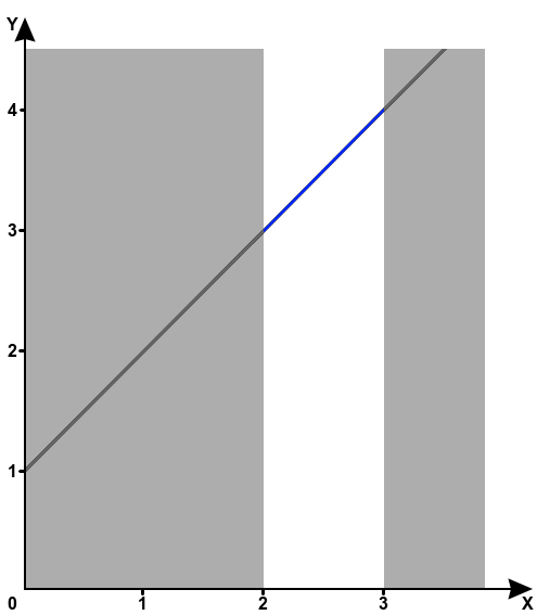

To visualize how the bounds work, consider another example in which the same bounds applied to the same straight line and the difference lies only in the Apply after calculation option, which significantly affects the result.
The lower bound equals 2, the upper bound equals 3, the Apply after calculation option is disabled
The lower bound equals 2, the upper bound equals 3, the Apply after calculation option is enabled

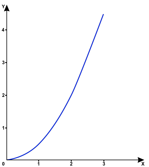

Sometimes, to understand the essence of a phenomenon, it’s better to go backward. If we know the precise formula Y=f(X), which relates the input and output values over the entire range, then there is no need to use the calculation table. It’s better to use the expression in the Parameter field instead. Let’s consider such a case.
Suppose that an input value is related to an output value by the Y=0.5⋅X2 formula.
Let’s take adc3 as a parameter. To describe such a formula in Wialon, insert the following expression into the Parameter field: const0.5*adc3^const2
The chart of the Y=0.5⋅X2 function

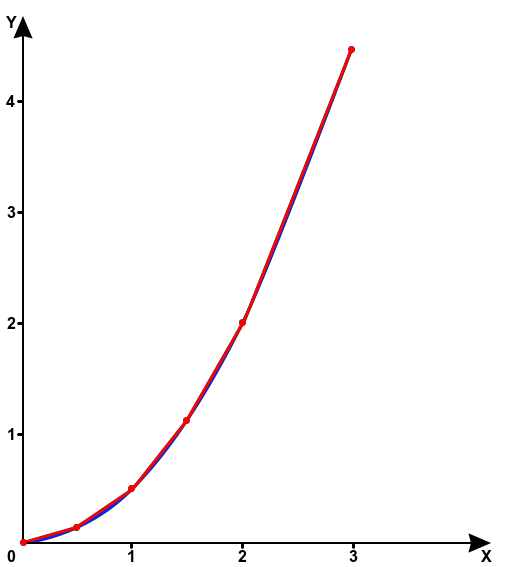

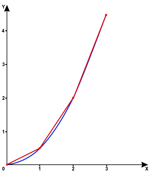

But what if we don’t know the precise Y=f(X) formula? In this exact case, the calculation table will help us.
Suppose that we know the values of the measured value (it will be Y), and we can check what value the parameter will take in Wialon at those points (it will be X). Thus, you can get values, for example, at four points: (0; 0), (1; 0.5), (2; 2), (3; 4.5). Next, plot these points (X, Y) on the chart and connect them with red lines.
Reproduction of a part of the function Y=0.5⋅X2 by lines built on four points
It is easy to see that the result is close to that obtained by the formula, but there are still differences. In some cases, this accuracy will be sufficient, but if it is not enough, you can measure values ​​at more points. The chart below shows an example for six points: (0; 0), (0.5; 0.125), (1; 0.5), (1.5; 1.125), (2; 2), (3; 4.5).
Reproduction of a part of the function Y=0.5⋅X2 by lines built on six points
From the considered example, we can draw the following conclusion: the relationship between X and Y can be described by a formula, but also it can be simplistically described with the help of several straight lines. This is the essence of using the calculation table.

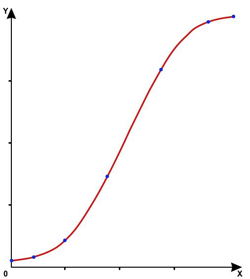

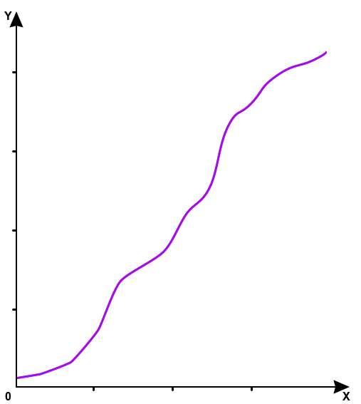

The curve that describes the relationship between X and Y can be quite complex.
For example, using a fuel level sensor requires calibrating the fuel tank, and the shape of the chart built according to the calibration table will depend on the geometry of the tank, which is never ideal (it may have roundings, dents, internal stiffeners, and so on).
The chart based on the calibration table with small steps between measurements
It is problematic to describe such dependence in one formula. An easier way to describe this curve is to break it down into intervals where it behaves roughly like a straight line and determine the formulas for those lines. You can do it using XY pairs.

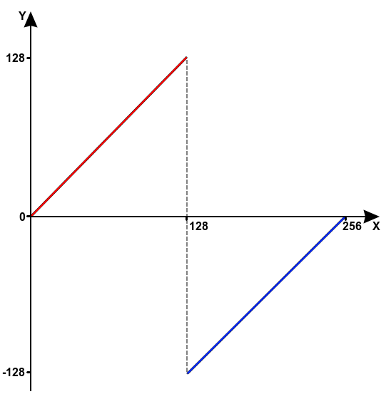

Also, sometimes the relationship between X and Y can vary over several intervals. To describe it, you need to use a system of several expressions, which cannot be done in the Parameter field in the sensor properties.
For example, some temperature sensors work as follows: X values in the range from 0 to 127 correspond to a positive temperature, and in the range from 128 to 255 — to a negative temperature. You will need a calculation table with two rows to handle such a case:
X=0; a=1; b=0
X=128; a=1; b=-256
The temperature chart where higher parameter values correspond to negative temperatures
