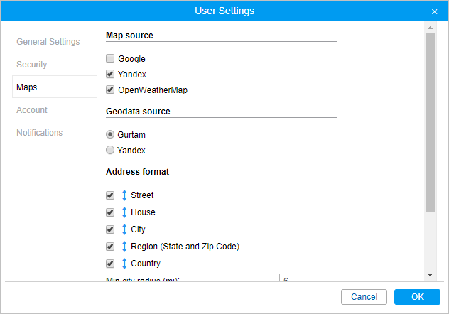

Maps
Maps settings are adjusted in the User Settings dialog on the Maps tab.
Map source
Here you can enable or disable map sources selecting them in the list. Changes are applied after clicking OK and refreshing the page. Then you can select a map in the maps menu.
The following maps can be used in Wialon: Google, Bing, Kosmosnimki, 2GIS, WikiMapia, Visicom, Yandex, HERE, Regio, Luxena, what3words, MyIndia, ArcGIS, GoMap.az, Mapbox, OpenStreetMap, Amap, Namaa, and such additional layers as OpenSeaMap, OpenWeatherMap, AerisWeather. By default, all address information in Wialon Local is taken from the WebGIS server. However, it is possible to take the address information from the Gurtam Maps cartographic service (for a fee).
If you enable certain map sources, several types of maps are displayed in the menu at once. For example, if you select the Google map source, the menu shows such maps as Google Streets, Google Physical, Google Satellite, Google Hybrid, and Google Street View for tracking on minimaps. For some types of maps, additional layers are available (for example, traffic layer or maritime navigation).
Geodata source
In this section, you can select the source of address information used in the Monitoring panel, in the tooltips of units and tracks, in the Messages panel, in notifications, and while creating geofences and routes. Possible sources of geodata are Gurtam, Google, Visicom, Yandex, Mapbox, HERE, Luxena, what3words, ArcGIS, Amap. Only the maps that are activated in the site’s properties are displayed in the list of available.
If Google (standard) or Yandex (standard) — geocoding service is activated for the account and Google or Yandex is selected as the geodata source, the information about the location of the unit is shown in the reports in accordance with the format of the maps provider.
For the Gurtam geodata source, it is possible to activate the MGRS coordinates option if the user has the MGRS service.
If a geodata source other than Gurtam is chosen, the Address format block becomes unavailable.
Address format
Here you can specify the format for displaying address information in tooltips, tools, messages, and other places. Choose which of standard address components should be displayed: country, region, city, street, and house (at least one of these items should be selected). For example, if your units move mainly within the same city or town you can omit the country, region, and city and leave only the street name and house number in addresses. Address components can be put in any order. To change this order, drag components up and down using the arrow-shaped buttons. This format affects addresses mainly in cities/towns/villages.
Available only for Gurtam Maps.
This format is especially relevant if the units are moving around the city. For addresses outside the city (near roads), the following two settings are important:
  • Max distance from unit determines that if the unit is on the road or close to it and there is a city/town/village at a specified distance, the address is displayed as the name of the road and the distance to that city (if several cities are found, then to the nearest one).
  • Min city radius determines that if at a distance specified as Max distance from unit, no settlement is found, then the address is bound to some other city. The radius of the city that can get into the address information can be specified in this parameter. It may be necessary, for example, if only large cities should appear in addresses.
Coordinate format
The coordinates of the cursor shown in the lower right corner of the map can be either in degrees or in degrees and minutes. This option only influences the cursor’s position format.
For the Map source and Coordinate format blocks, there is a possibility to check all the boxes at once. To do so, hold the Ctrl key and check any box of the corresponding block.
