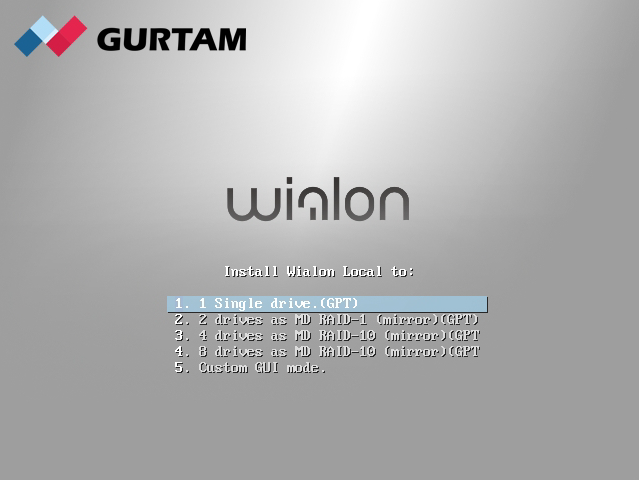

  1. Select the installation type: one, two (RAID-1), four (RAID-10) or eight (RAID-10) drives.

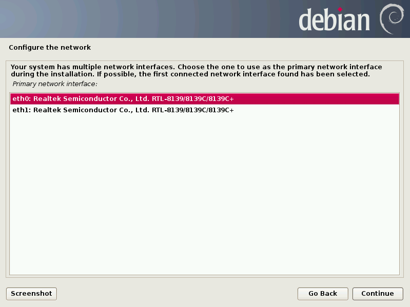

  2. If more than one network is detected, you will be asked to select which one should be used during the installation process.

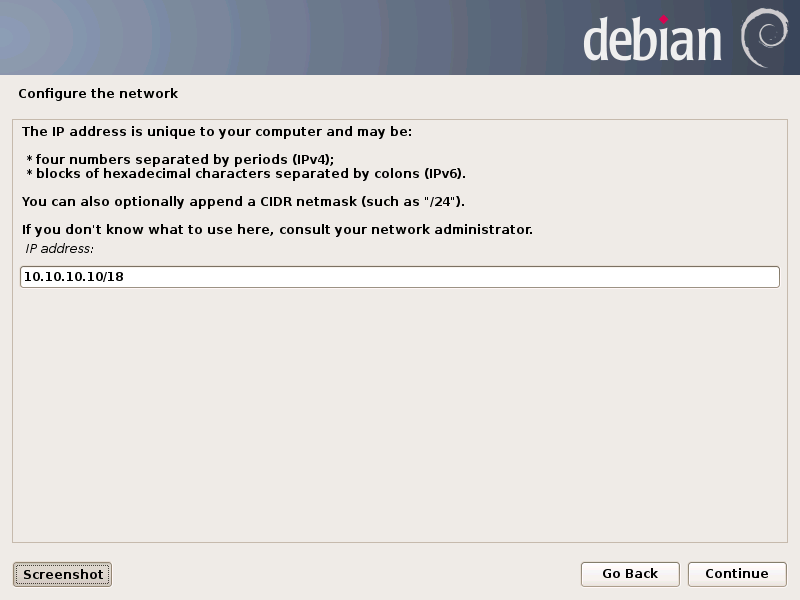

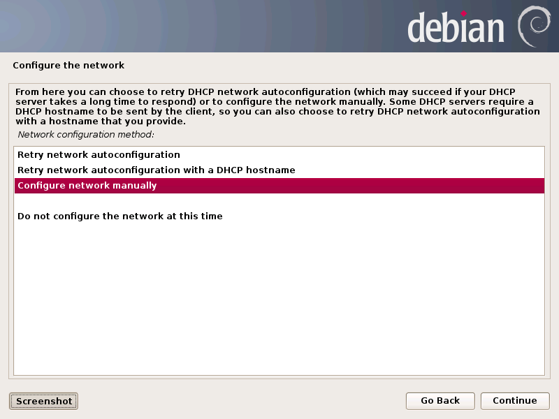

    However, if DHCP server is not available during the installation, check network availability and repeat network adjustment or set network parameters manually:

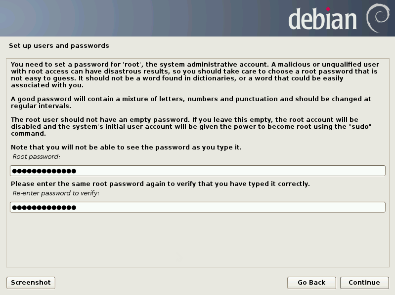

  3. Set up password for the root account — main account of your Debian OS.

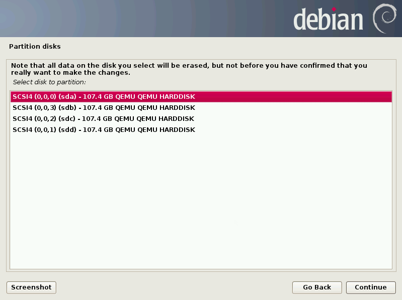

  4. If installation on one drive was selected at the beginning, specify a particular drive here.

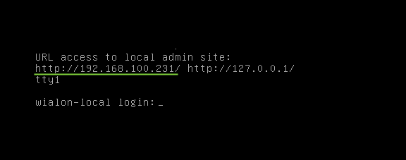

  5. When the installation process is complete, the system will reboot automatically (do not forget to readjust BIOS settings back). After the reboot, the URL address of Wialon Local administration system will be shown.

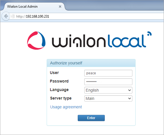

  6. Enter this URL in the address bar of a browser on a computer with a graphical interface that has access to the server with Wialon Local. To authorize, use the username and password given to you when purchasing Wialon Local. In the Server type line, select Main if you are installing Wialon Local for the main server. Select Backup if you are installing Wialon Local for the backup server. See Installing a backup server for details.

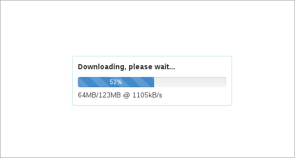

  7. After a successful authorization, Wialon Local will be downloaded and installed. This may take some time.

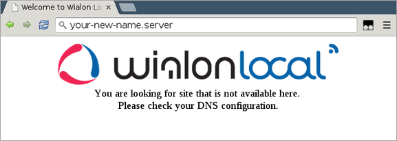

When you first log in to the administration system, you can receive a message that reads: You are looking for site that is not available here. Please check your DNS configuration.
In this case, you should register your new address for the administration system in the /etc/nginx/conf.d/lcm.conf file.
For example:
server_name      192.168.100.231 127.0.0.1 your-new-name.server;
