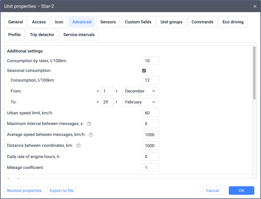

Additional settings
The parameters available in this section influence the calculations of fuel consumption, mileage, engine hours and other data.
ParameterDescription
Consumption by rates
Fuel consumption per 100 kilometers. Another unit of measurement can be used, depending on the selected measurement system. The default value is 0.
Seasonal consumption
The option which allows you to specify a separate fuel consumption rate for a certain period. The default value is 0.
If the Seasonal consumption option is activated, then when you create a new sensor using the math consumption wizard, the Seasonal coefficient, % option is activated there by default. The value of the coefficient is calculated in accordance with the values specified on the Advanced tab.
Urban speed limit
The maximum speed at which it is conventionally considered that the unit is moving within the city. Moving at a higher speed is considered as suburban mileage. You can use this setting in reports: in the Trips table, in statistics, in the advanced report on drivers.
Maximum interval between messages
The maximum interval between messages in seconds.
If the time difference between two messages exceeds the specified value, such a time interval is considered a connection loss. You can view the intervals of no connection in the Connection problems report.
The option can affect:
  • the calculation of fuel consumption by maths and FLS;
When determining engine hour intervals, the option is used if its value is smaller than the value specified for the Timeout option of the sensor. When determining fuel filling and drain intervals, the option is used if its value is smaller than the value of the Minimum parking time option.
  • the determination of engine hour, fuel filling and drain intervals;
  • the display of tracks and charts: the lines are interrupted where the specified value has been exceeded.
The default value is 0 (option disabled).
Average speed between messages
This option is used to exclude coordinate outliers when calculating mileage.
Maximum average speed of the unit determined by two successive messages, in km/h. If the specified value is exceeded, these messages are not taken into account when calculating the mileage in reports, in the GPS and GPS + engine ignition sensor mileage counter and on the Messages tab.
To disable the option, specify 0.
Distance between coordinates
Maximum distance between coordinates in two successive messages, in km. If the specified value is exceeded, these messages are not taken into account when calculating the mileage in reports, in the GPS and GPS + engine ignition sensor mileage counter and in the Messages tab.
  Daily rate of engine hours
The daily rate of engine hours (in hours). This value can be used in the report on engine hours (when calculating utilization and useful utilization). The operation of engine hours is determined by the engine hours counter.
Mileage coefficient
The coefficient used to correct the mileage calculated in Wialon in cases where it always differs from the actual mileage by a certain number of times.
Example. The mileage calculated in Wialon is 100 km, and the actual mileage (determined by the vehicle equipment) is 120 km. The mileage coefficient that should be specified in this field is 120/100 = 1.2.
The result of multiplication by the coefficient is shown in the Mileage (adjusted) column in different report tables and statistics.

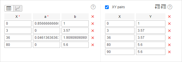

How to determine fuel consumption, if I know how much fuel the unit consumes within the city, and how much outside it?
Let us suppose that the fuel consumption in the urban cycle is 10 l/100 km and 7 l/100 km — in the suburban cycle.
  • Create an ignition sensor (as in the example above) and set 1 l/h for the consumption during idling.
  • The average consumption in the urban cycle is 36 km/h, in the suburban — 80 km/h.
  • The unit will cover a distance of 100 km driving at a speed of 36 km/h in 2.8 hours. 10 l / 2.8 = 3.57. Let us calculate the value of the increasing coefficient when moving in the city: 3.57 / 1 (idling) = 3.57.
  • As a result of a similar calculation for the suburban cycle, we obtain the coefficient equal to 5.6.
  • Create an engine efficiency sensor, taking into account the fact that the unit cannot consume less fuel than during the idling, and that it is stationary before the beginning of the movement. As a parameter we use the average speed (speed + # speed) / const2 and fill in the calculation table (manually or using the calculation table wizard):
Note that the last pair of points is how the system calculated before (the fuel consumption was considered constant for a speed above 80 km/h). You cannot use this method and change the set of points. Also ‘3’ in this example is the minimum speed from the unit’s trip detector, consequently, this parameter can be different for your unit.
Result: in our example, the average consumption has been calculated for the unit. It has been calculated relative to the speed and time between messages and taking into account the values of the vehicle operation.

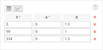

How is the seasonal coefficient calculated?
As a rule, the seasonal coefficient supposes increased fuel consumption. For instance, the consumption in winter is 30% higher than in summer. Let us suppose, that the winter in your climate is from December, 1 to March, 1.
  1. Create an engine efficiency sensor with the parameter time:d.
  2. Find out which numbers of the day in the year do your dates correspond to. High precision is not obligatory: a year may be a leap one and the season itself may be longer or shorter. For the period indicated above, for example, the numbers are ‘334’ and ‘59’ approximately.
  3. Create a calculation table as seen in the screenshot below.
time is the parameter that is present in any message from any device, and the system will calculate the number of the day automatically on its basis. In that way, as the season starts, 30% will automatically be added to the fuel consumption.

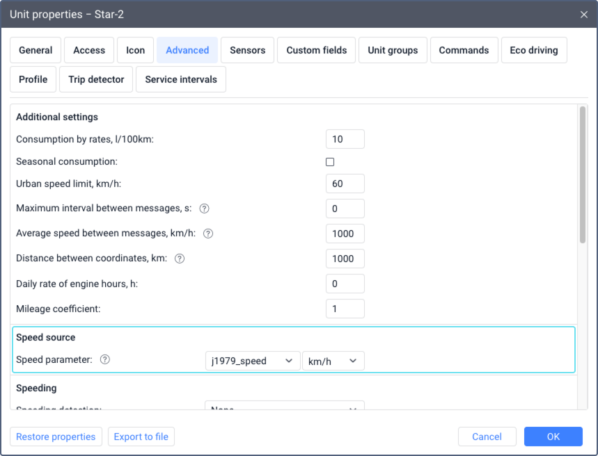

Speed source
This section is shown for certain device types for which changing the speed source is supported in the monitoring system.
In most cases, the monitoring system uses the values calculated by the device via GPS as speed values. They are stored in the unit messages in the speed parameter. If they are not correct, you can specify the parameter the values of which should be used for the speed parameter.
To set the speed source correctly, follow the steps below.
  1. In the Speed parameter field, select or specify the name of the parameter (no more than 50 characters) the values of which should be used as speed values. The list shows all the parameters sent by the device, except for the virtual ones.
  2. Select the unit of measurement in which the device sends speed values (not the unit of measurement which should be shown in the monitoring system). If the unit of measurement is not selected, the system uses km/h.
  3. Save the changes.
After that, the speed value is taken from the specified parameter.
After that, the speed parameter values from the unit messages begin to be replaced by the values of the specified parameter in all parts of the system without the possibility of recovery. If the messages don’t contain the specified parameters, the usual values of the speed parameter are used.
The speed value of the specified parameter is not taken into account in the system if the location is determined by LBS (see the Allow positioning by cellular stations option). Namely, the unit tooltip, the extended unit information and the Speed column in messages show 0.

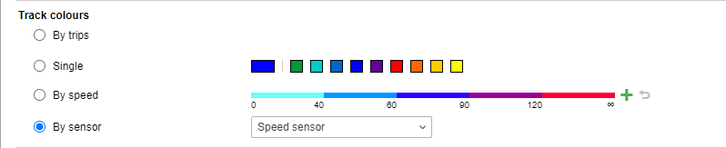

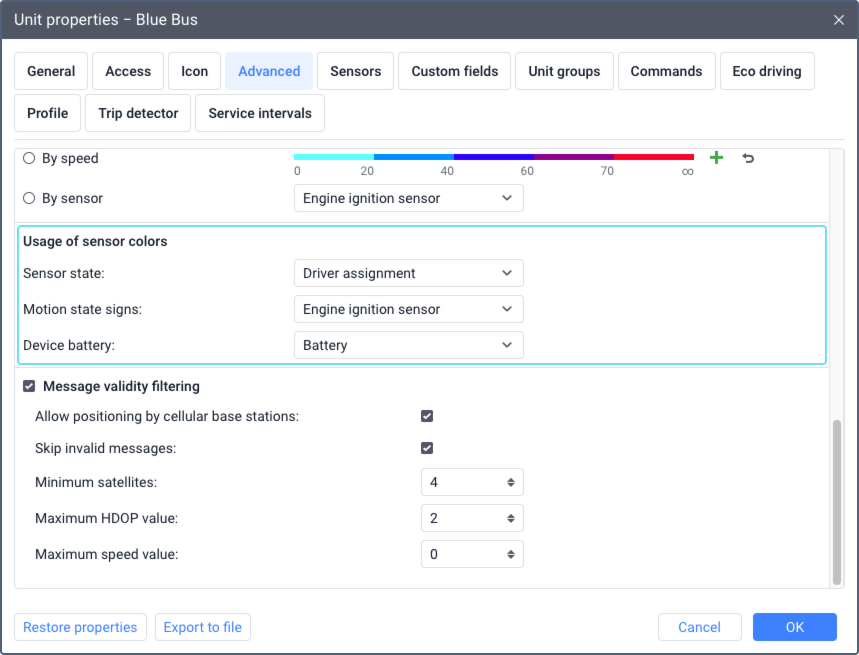

Unit caption color
By default, the names of the units and the drivers assigned to them are shown on the map in red. However, you can select a different color for each unit.
Track colors
