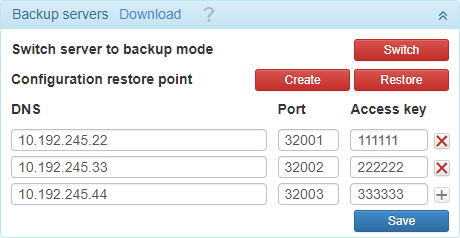

Backup Servers
This section contains settings associated with the operation of backup servers.
The options available in the section are listed below.
OptionDescription
Switch server to back up modeThe option which allows switching the backup server to the primary mode. See more.
Configuration restore point
The option which allows creating a copy of the configuration data and restoring such data.
DNS, Port, Access key
In these fields, you should specify the DNS, port, and access key for each backup server, respectively. These parameters are verified against those specified in the config.txt file of the backup server.
