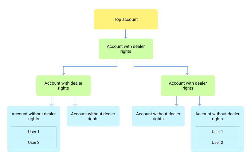

Account types
There are the following types of accounts in Wialon:
- top account,
- account with dealer rights,
- account without dealer rights.
Top account
The top account is named wialon and is available to the service owner from the moment of activating Wialon. The same-name billing plan available to the service owner includes all the purchased functions. These are a system account and plan, therefore, the service owner cannot edit them.
Special features are available for the top account:
- creating billing plans,
- adding and configuring Apps,
- restoring the deleted objects from the trash.
Account with dealer rights
It is not recommended to create units in an account with dealer rights.
Account without dealer rights
Like other users, the user of such an account works with the system in accordance with their rights: controls the movement of units, monitors drivers and trailers, executes reports, and so on. Besides, the user without dealer rights can create units in their account, which is not recommended in an account with dealer rights and not available in the top account.

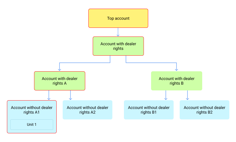

Configuring the hierarchy
- A subordinate account cannot have more rights and features than a parent one.
- When objects are created in a subordinate account, the rights to them are automatically given to the users indicated as creators in the vertical hierarchy. For example, in the image below, a unit has been created in the account without dealer rights A1. All the users who are indicated as creators and whose accounts have a red outline have received access rights to the unit.
- It is recommended to create a separate account for each client.
- It is not recommended to give access to the top account to all employees.
- It is not recommended to increase the number of levels and branches in the hierarchy unless it is necessary, because it slows down the system.

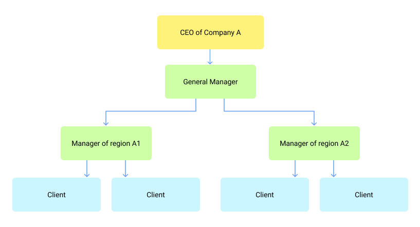

Example 1
- Create an account for the general manager. In its properties, activate dealer rights and select all the billing plans.
- Create accounts for the managers of regions A1 and A2. Specify the general manager as their creator. In the properties of the created accounts, activate dealer rights and select the billing plans which the managers can assign to the clients.
- Create a separate account for each client. Specify the manager of the client’s region as a creator and assign an appropriate billing plan to the client. In the account properties, specify the required parameters.

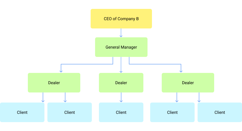

Example 2
- Create accounts for the dealers. Specify the general manager as their creator. In the properties of the created accounts, activate dealer rights and select all the billing plans which the dealers can assign to their clients.
- Now the dealer can organize the hierarchy of subordinate accounts depending on the specifics of their business.
