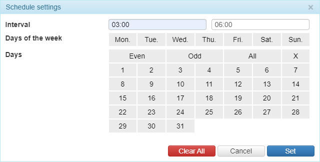

If the Auto-install option is enabled, the system detects available updates automatically. After enabling the option, you can choose when to install the updates: as soon as they are available or according to the schedule. In the schedule settings, you can select days and the time interval within which the updates should be installed.
To change the fixed schedule, click on the Set schedule link.

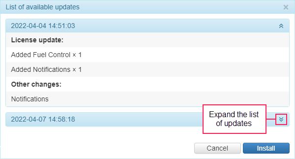

If the Auto-install option is disabled, you will be informed about the updates in the log. Besides, a corresponding phrase is displayed in the Updates line (for example, Available: 3 instead of Up to date).
To install all available updates, click Install. To open the list of available updates, click on the Available link.
You can’t install specific updates. All available updates are installed at once.
After installing the updates, you can click Up to date to see the list of the applied updates.
