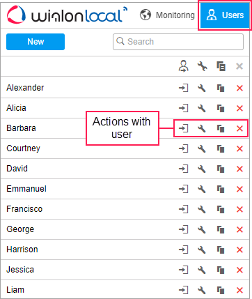

Actions on the “Users” tab
To add a new user, click on the New button and follow steps 2–6 of the guide from the Creating users section.
Using the icons opposite the user name in the list, you can perform the actions described below.
IconAction
Log in to the system on behalf of another user. The icon is inactive if you don't have the Act on behalf of this user access right to the user. See more information about this login method here.
Open the user properties to view or edit them. Depending on your access rights, the window may show up to six tabs:
Create a new user with the same properties. A click on the icon opens the window for creating a new user where you can make changes and save them.
Delete the user. The icon is inactive if you don't have the right to delete this user. See more information about the peculiarities of deleting users here.
