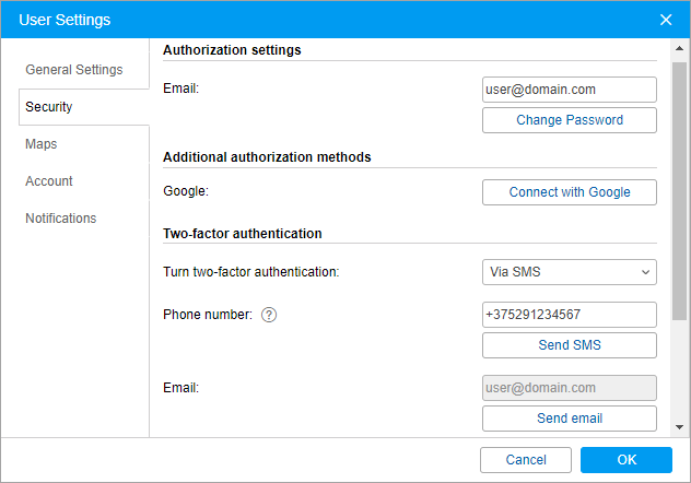

Two-factor authentication

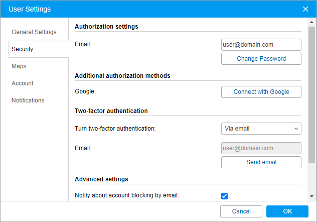

To enable two-factor authentication, in the drop-down menu select the method of receiving the confirmation code: via email or SMS.
Via email
The code is sent to the email address specified in the authorization settings. To confirm the address, press the Send email button and enter the received code in the line that appears.
Via SMS
Specify the phone number to which you want to receive a code. To confirm the phone number, press the Send SMS button and enter the received code in the field that appears. Standard rates apply for SMS messages.
To receive text messages, you should activate the SMS messages service in the account properties and the Can send SMS option in the user properties.

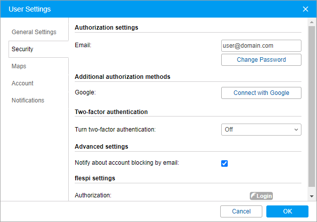

Advanced settings
Notify about account blocking by email
Enable this option to receive notifications about account blocking to the email address specified in the user properties. Notifications start arriving daily 5 days prior to blocking.

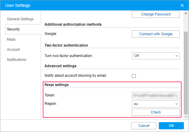

flespi settings
Authorization
To obtain a token, click on the Login button and authorize in flespi.
Token
The field with the generated token is displayed after successful authorization in flespi. The token is valid for one year. To see the information about the status (active/expired) and the expiration date of the token, click on the Check button. If necessary, you can edit the token manually.
Region
The data of flespi users can be stored in data centres in Russia or the Netherlands. The required region (ru or eu respectively) is selected by the user when authorizing in flespi.
In the user settings in Wialon, the region is displayed automatically for the generated token. If you indicate the token manually, select its region in the drop-down list.
