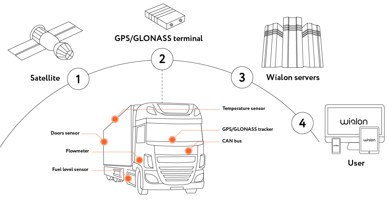

How does the monitoring system work?
The AVL hardware installed in a vehicle figures out the location of that vehicle with help of satellites, gathers data from various accessories and sensors and transmits the data through a cellular or satellite network to Wialon data center. This data can be interpreted to monitor in the Wialon web interface the whereabouts and other parameters of a vehicle in real time.
