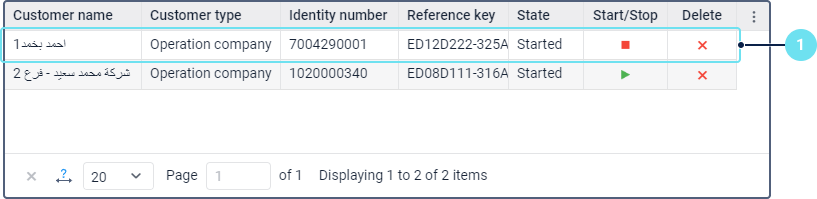

  1. In the table of customers, click on the row of the customer for whom you want to register a driver.

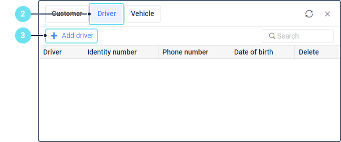

  2. Go to the Driver tab.
  3. Click Add driver.

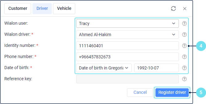

  4. Fill in the fields below.
    All the fields are required. Except for the Phone number field, you can’t edit them after the driver is registered.
    Field
    Description
    Wialon user
    Select your customer’s Wialon account.
    Wialon driver
    Select the required driver from the list of drivers created in your customer’s Wialon account. If the list is empty, no drivers have been created in the account of your customer. You can’t select a driver who has already been registered.
    Identity number
    Specify the driver’s ID indicated on the driver’s licence. It consists of 10 digits.
    Phone number
    Enter the mobile phone number of the driver. It should contain at least 10 digits. The plus sign is added automatically before the number.
    Date of birth
    Select the type of calendar (Gregorian or Hijri) and specify the driver’s date of birth.
    Reference key
    The driver’s reference key. This field is filled in automatically after registering the driver.
  5. Click Register driver.
