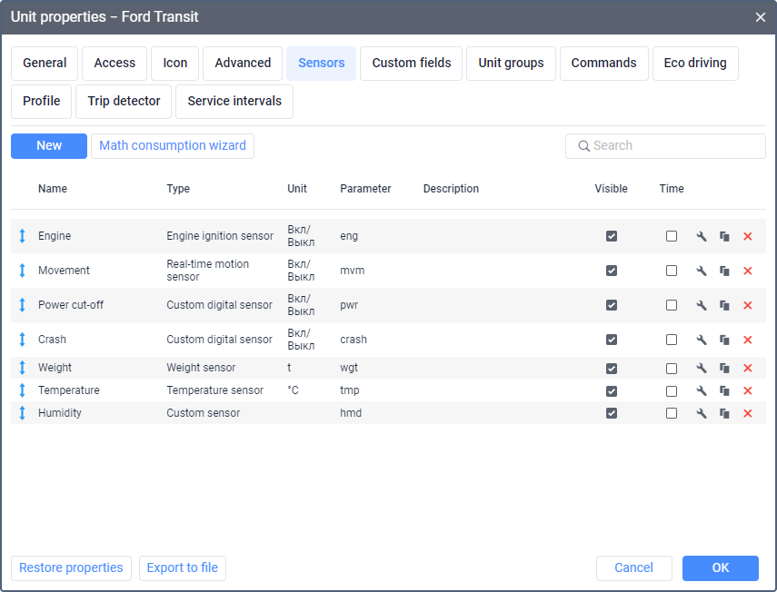

Prerequisites
To configure the sensors, you should have the following access rights to the unit:
  • View object and its basic properties;
  • Create, edit, and delete sensors.
Configure the sensors listed below in the unit properties.
The required sensors are marked with an asterisk (*). The sensors can have any names.
Sensor
Sensor type
Description
Engine sensor*
Engine ignition sensor
The sensor detects the ignition status (on/off).
Movement sensor*
Real-time motion sensor
The sensor detects if the unit is moving (on) or parked (off).
Power cut-off sensor*
Custom digital sensor
The sensor detects external power cut-offs.
Crash sensor*
The sensor detects traffic accidents.
Weight sensor*
Weight sensor
The sensor detects the total weight of the vehicle and freight in kilos.
Temperature sensor
Temperature sensor
The sensor is optional and detects the temperature value. If you configure the calculation table for this sensor, set 0 as the lower bound and 101 as the upper one, and activate the Apply after calculation option.
Humidity sensor
Custom sensor
The sensor is optional and detects the humidity value.

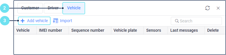

  1. In the table of customers, click on the row of the customer for whom you want to register the vehicle.
  2. Go to the Vehicle tab.
  3. Click Add vehicle.

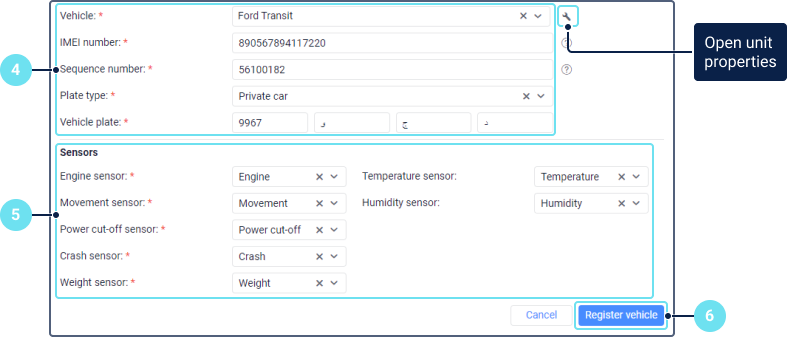

  4. Specify general information about the vehicle.
    The required fields are marked with an asterisk (*). After the vehicle is registered, you can’t edit any fields, except for the IMEI number.

  5. Select the vehicle sensors. Engine, movement, crash, weight, and power cut-off sensors are required. Temperature and humidity sensors are optional. You can’t select the same sensor in more than one field.
  6. Click Register vehicle.
As a result of successful registration, the vehicle is saved to the table of vehicles. A record of the registration is shown in the log.
