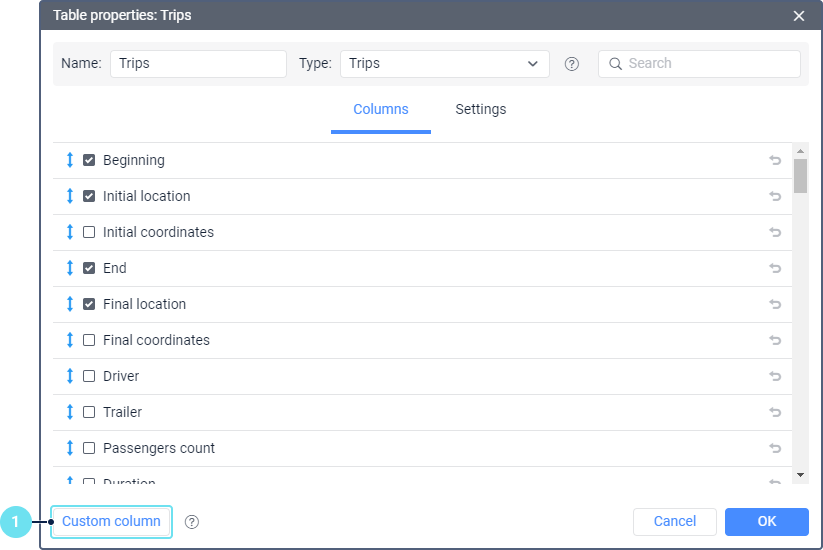

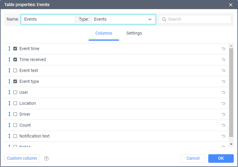

Selecting columns
The set of available columns depends on the selected table type. To add a column to the table, check the box to the left of its name. To add all columns at once, hold down Ctrl and mark any column which is not selected. You can cancel the selection of all columns in the same way. To quickly search for columns, use the dynamic filter in the upper-right corner.
To edit the name of a column, click on it with the left mouse button. To use the default name of the column, click on the icon in its line. The icon is inactive is the default name is used.
If necessary, you can change the sequence of columns in the table. To do this, click on the icon   to the left of a column and drag it to the required place while holding down the left mouse button.

  1. On the Columns tab of the table properties, click on the Custom column button.

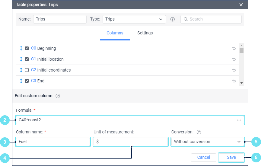

  2. Specify the formula for calculating the column value.

  3. Specify the name of the custom column.
  4. Indicate the unit of measurement (up to 10 characters).
  5. If you use the custom column to calculate duration, select how it should be displayed in the Conversion drop-down list.
    Item Description
    Without conversion Duration is displayed in seconds.
    Duration format The Duration format option from the table settings is used. If there is no such option, the result is displayed in the hours:minutes:seconds format.
    Date and time format The date and time format indicated in the user settings is used.
    If the value cannot be converted to the selected format, a dash is displayed in the custom column.
  6. Click Save.

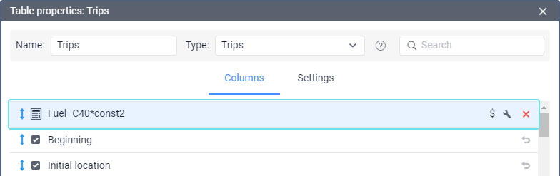

The custom column automatically goes to the top of the list. However, you can change its position in the standard way if necessary. Such columns are highlighted in blue and do not have an index.
To edit the created column, click on the icon wrench icon, column name, formula, or unit of measurement, make the necessary changes and save them.

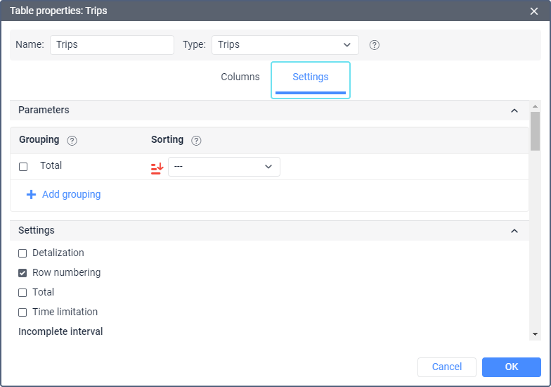

For each table, in addition to selecting columns, there are additional settings, located in the same-name tab.
The tab is divided into three sections:
