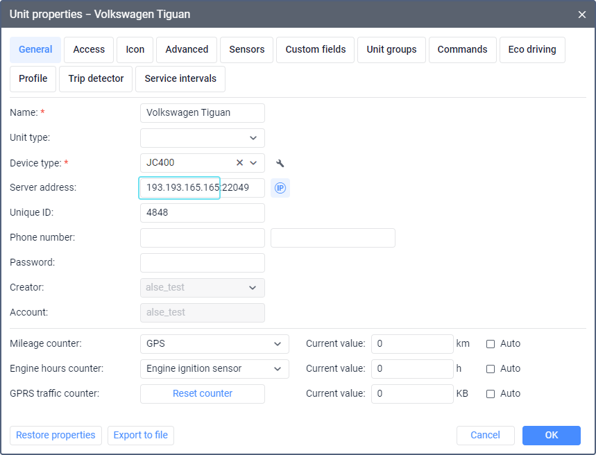

IP should be replaced by the address marked in the unit properties:
For example, according to the screenshot above, the commands should be the following:
  1. COREKITSW,0
  2. UPLOAD,http://193.193.165.165:22049
  3. SERVER,0,193.193.165.165,22049

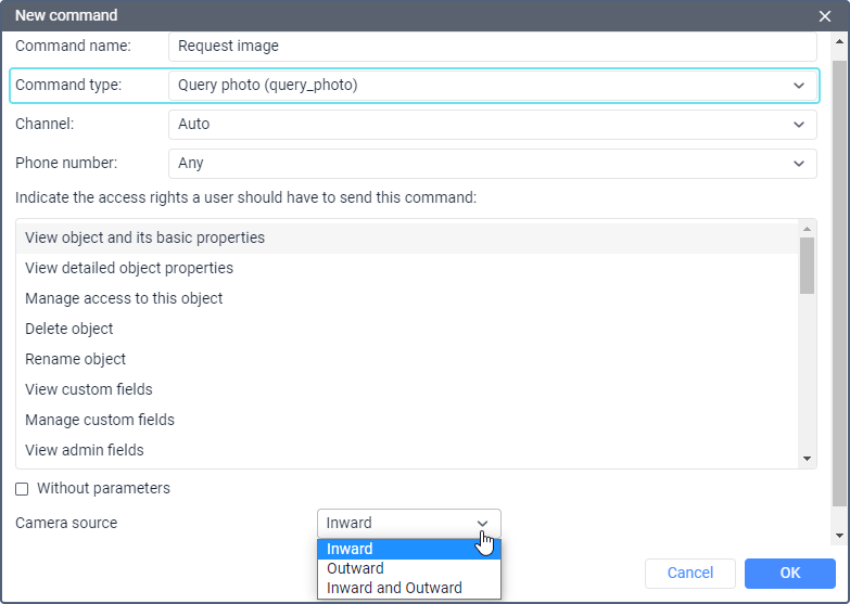

  • For the image request, use the query_photo command type.
