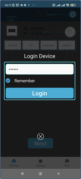

  1. Connect the dash camera to the Wi-Fi of your mobile phone. The device is available for connection only 3 minutes after switching on.
  2. Open the Howen iTool application and find the device. Use the refresh button if necessary.
  3. Log in. The default password is 111111.

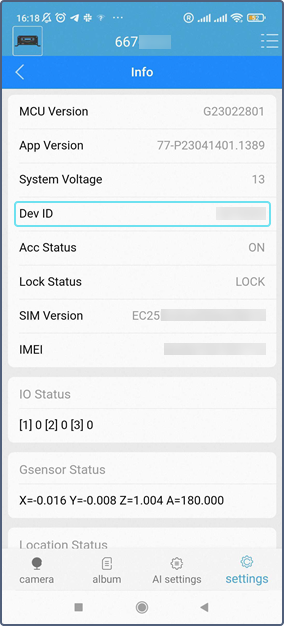

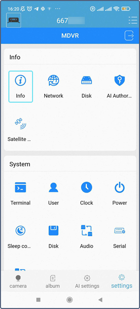

  4. Open the settings and select the Info item.
    You can find the device ID in the Dev ID line.

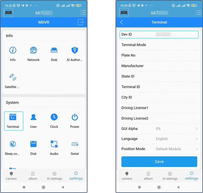

    If you need to change the ID, select the Terminal item of the System section in the settings. Change the ID in the Dev ID field and click Save.

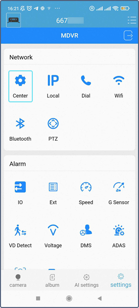

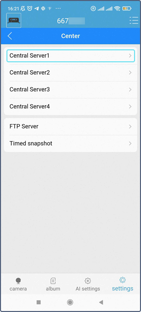

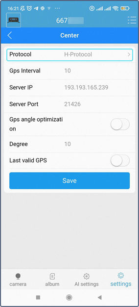

  5. In the settings, select the Center item of the Network section.
  6. Select the server.
  7. Select H-protocol in the Protocol list. Click Save.

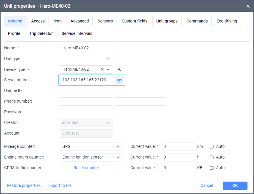

  8. Specify the server IP and port 22129. Click Save.
    You can find the IP address and port in the unit properties.

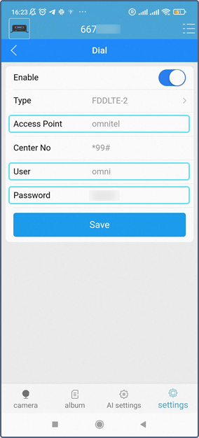

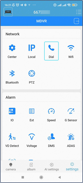

  9. In the settings, select the Dial item of the Network section.
  10. Specify the APN settings: fill in the Access point, User, Password fields according to the instructions of your mobile operator. Click Save.

The additional device settings are available in the unit properties upon clicking on the icon  next to the  Device type field.
The available settings are as follows:

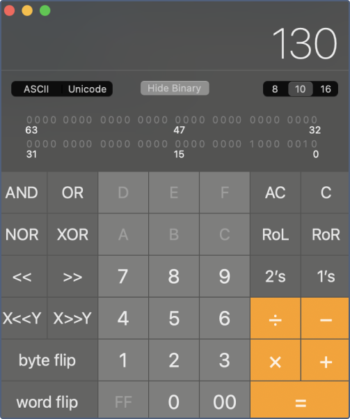

To find out the bitmask value, you should convert the bits into decimal values.
For example, if you need data from bits 1 and 7, enter the value 130 in the Content bitmask  field.
