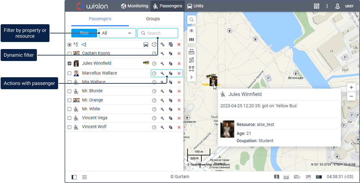

Managing passengers
By default, passengers are listed in alphabetical order. To switch between the forward and reverse alphabetical order, use the icon  /. To quickly find the required passenger, use the dynamic filter or the filter by property (assigned or separated passengers) or by resource.
In a passenger tooltip, you can see the name of the passenger, enlarged image, the resource to which the passenger belongs, and custom fields (if added). If the passenger is assigned to the unit, the tooltip also displays information about the assignment: date and time of getting on and off, unit name, and address. The icon of the unit to which the passenger is assigned, is displayed in the passenger row. When you point to this icon, you can see the unit tooltip.
Actions with passengers
You can perform the following actions with passengers:
Icon Action
View the assignment history of passengers or delete records of assignments from it.
/ View or edit the passenger properties.
Copy, that is, create a new passenger using the selected one as a template.
red cross icon Delete the passenger. The icon is inactive if you don’t have the Create, edit, and delete passengers access right.
