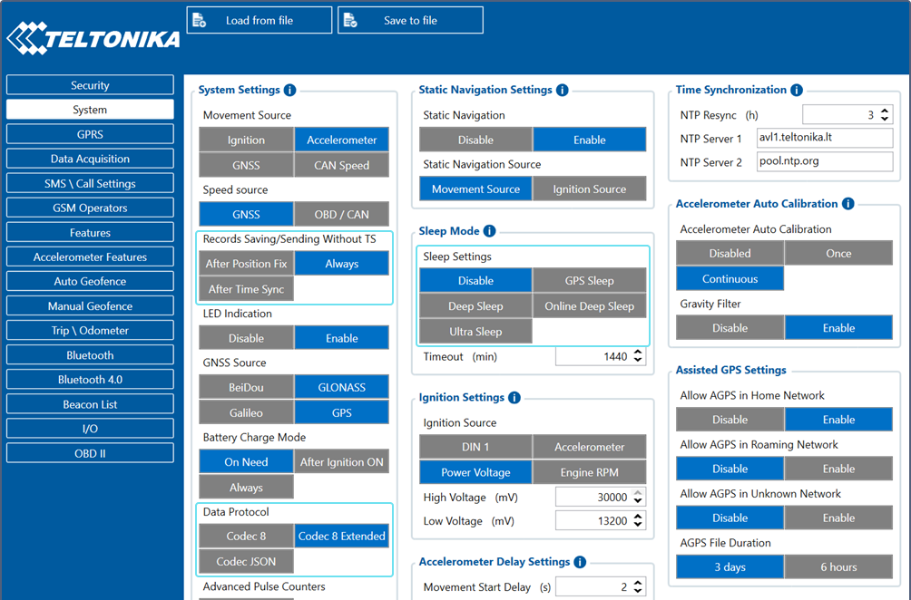

  2. On the System tab, configure the following settings:
    a. Set Recordings Saving/Sending Without TS to Always.
    b. Set the data protocol to Codec 8 Extended. The Teltonika Codec 8 protocol is also supported, but allows sending a fewer number of parameters.
    c. Disable the Sleep mode.

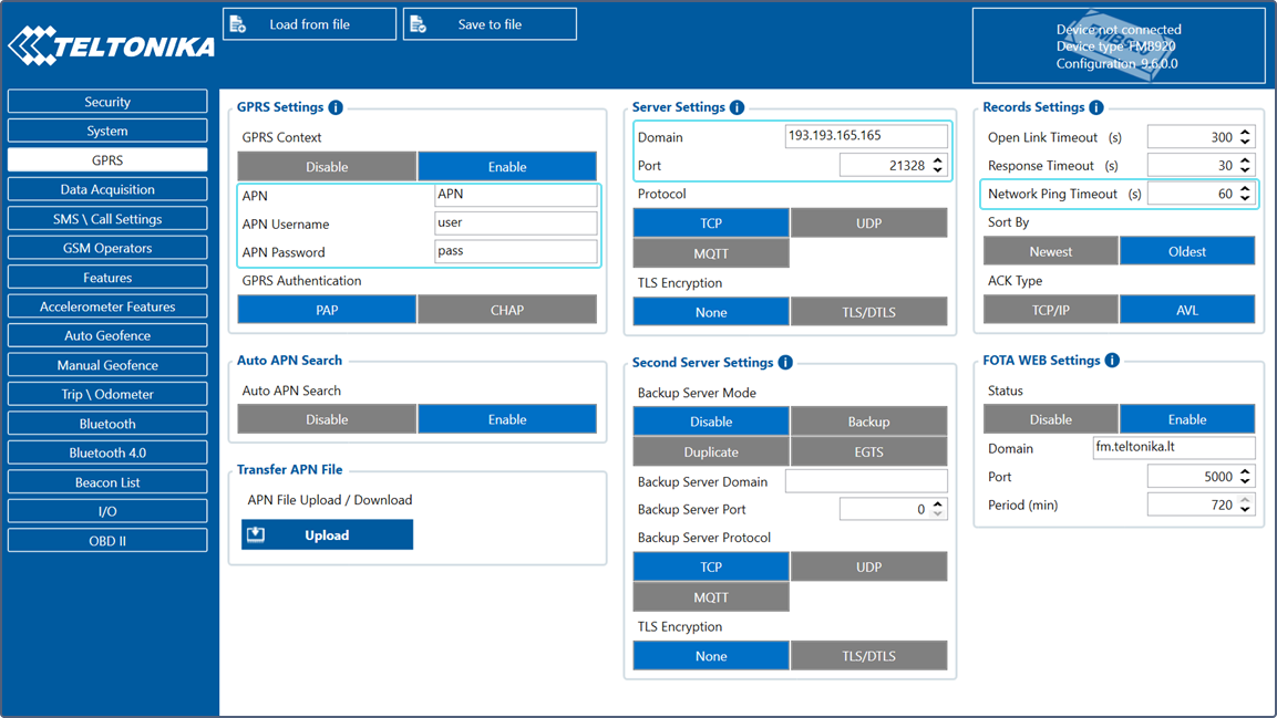

  3. On the GPRS tab, configure the following settings:
    a. Specify the APN settings: APN, username and password (this information can be requested from your SIM provider).

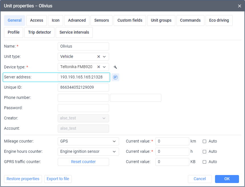

    b. Set the domain and port specified in the unit properties in Wialon.
    c. Set the network ping timeout to 60 seconds.

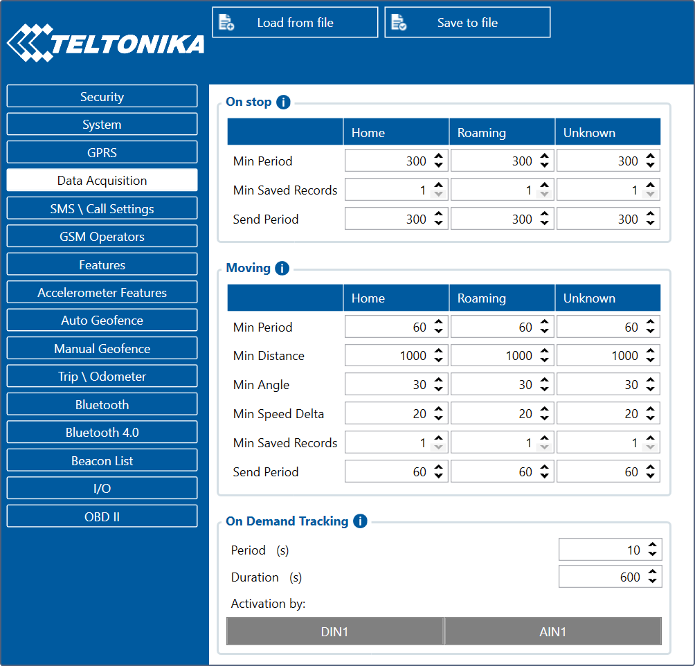

  4. On the Data acquisition tab, set the intervals for sending data based on time period, distance travelled, angle and speed changes. You can see the recommended settings in the screenshot:

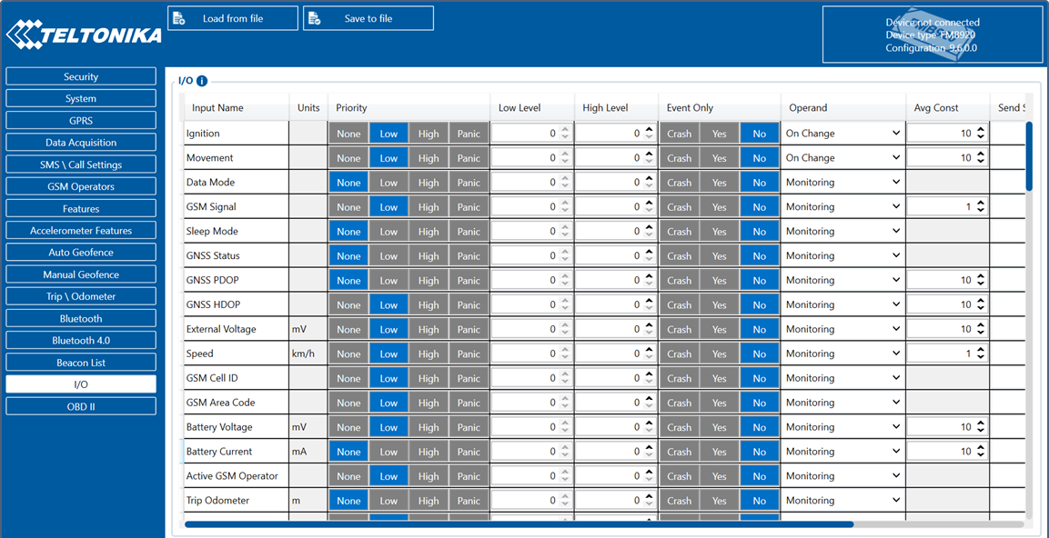

  5. On the I/O tab, select the parameters that you would like to get and set their priority from None to Low. If you don’t need certain parameters, set their priority to None.

  7. Use the device IMEI as the unique ID in Wialon.

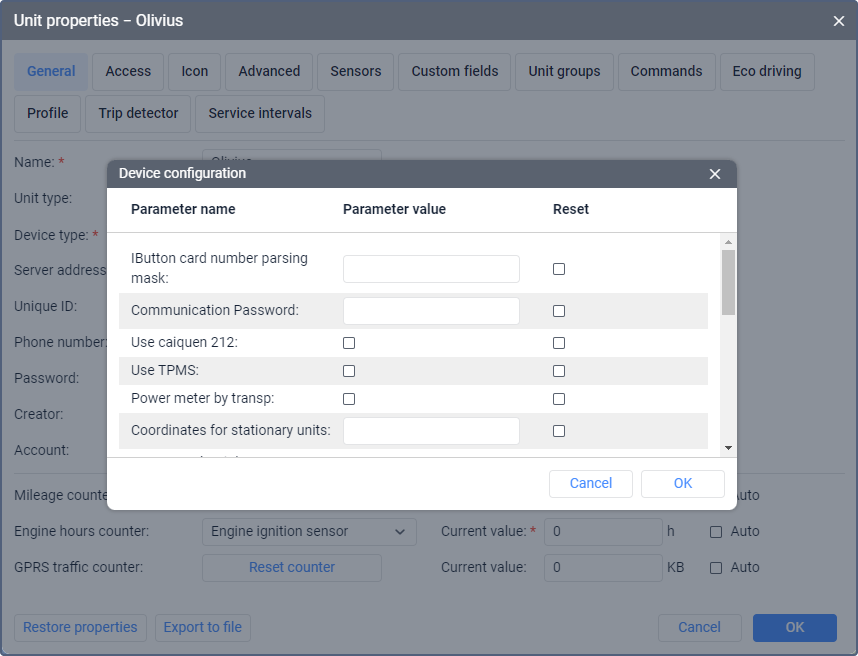

The additional device settings are available in the unit properties upon clicking on the icon   next to the Device type field.
The available settings are as follows:
