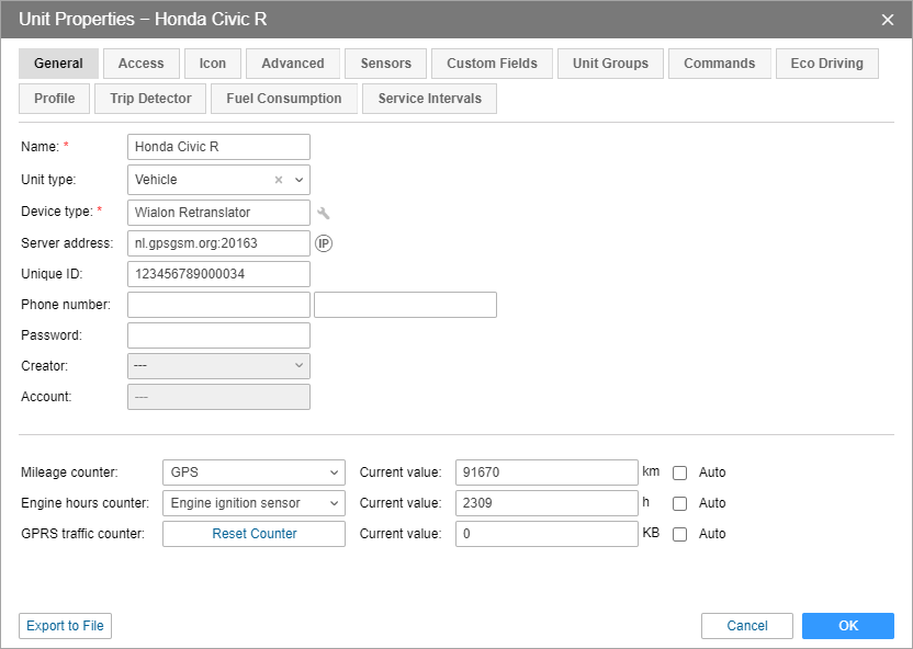

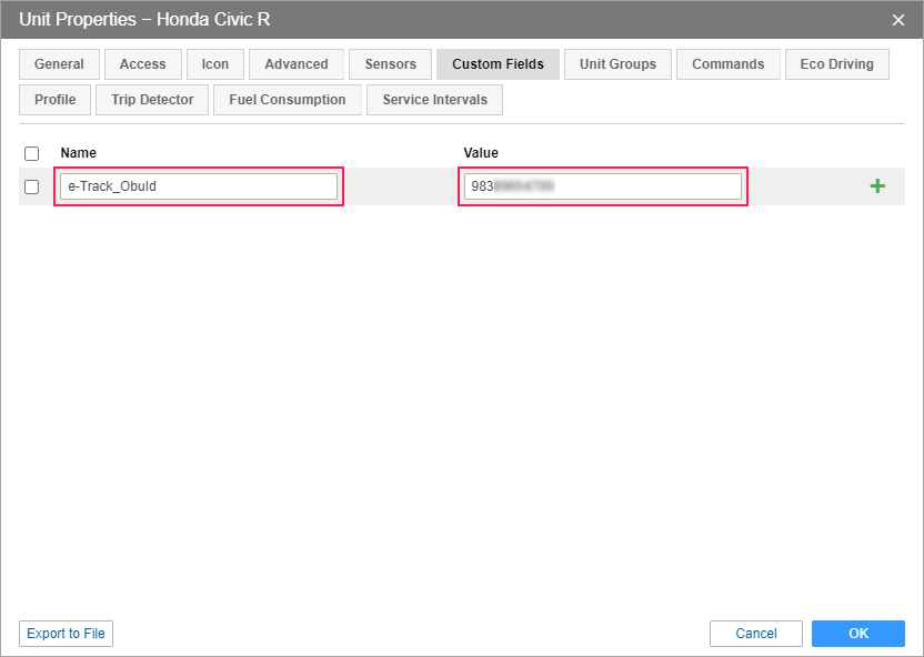

  • Open the properties of the unit for which you want to configure automatic toll payment (or create a new one).
  • Go to the Custom fields tab and add a custom field named e-Track_ObuId. In the Value field, specify the on-board unit ID (OBU ID) received after signing up for the e-track platform.

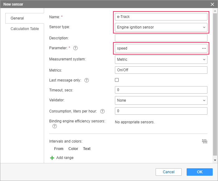

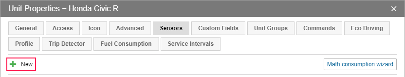

  • Go to the Sensors tab and click New. If an ignition sensor has already been created for the unit, skip this and the following step.
  • Specify the sensor name and select the Engine ignition sensor type. If the unit does not have an ignition sensor connected, specify speed in the Parameter field. If the ignition sensor is connected, specify the ignition parameter.

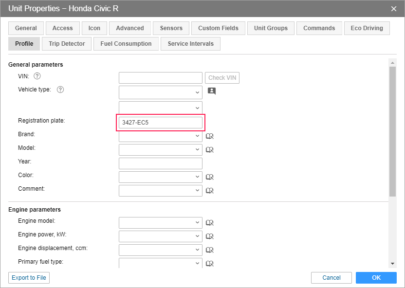

  • Go to the Profile tab. In the Registration plate field, specify the same number you entered when signing up for the HU-GO system. Click OK.

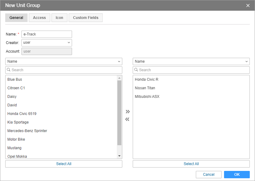

  • Create a unit group and add to it units for which you want to configure automatic toll payment.

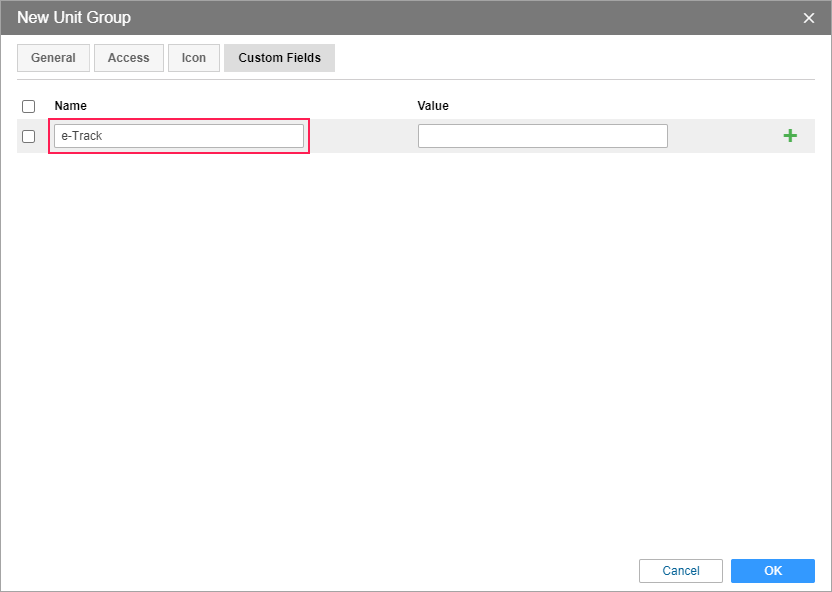

  • On the Custom fields tab, add a custom field named e-Track. Leave the Value field blank. Click OK.
